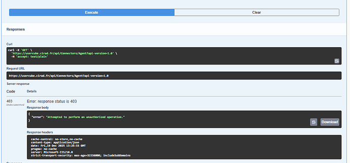

Hello, thank you for your feedback.
Attached is the 403 error I get when using Swagger while being logged in as an admin on the browser.
I have opened an incident, and support has confirmed the issue. I am waiting for their response. I am surprised that it only doesn’t work in our environment.

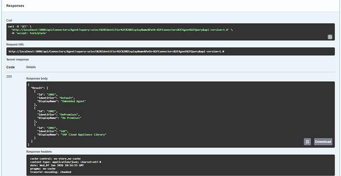

Hello,
This is a permission issue.
For security reasons, access via APIs requires explicit permissions on the objects.
While waiting for a fix or a more detailed procedure, I can suggest the following workaround:
  1. Identify the missing permission
    It can be found in the URL.
    Example: For Agent, the call URL “http://localhost:5000/api/Connectors/Agent…”.
    The missing permission is “/Connectors/Agent”.
  2. Add the permission to the Administrator profile
    Add the following AccessControlRule:
    *<Entry Permission="**/Connectors/Agent/Query**" CanExecute="**true**"/>*
    Note: 3 important points:
    1- EntityType=“Agent”: to define the object of the API call
    2- Permission=“/Connectors/Agent/Query”: the identified permission + the type of action (Query, Create, Update, Delete)
    3- CanExecute=“true”: to allow the API call
  3. Perform the API call
    In the squery field, list the attributes to return with the “select”.
    In the Path field, copy the permission defined in the AccessControlRule.
The Path parameter in the API is a mandatory field.
You can find them all here:
References: Permissions | Netwrix Product Documentation
Thank you for your answer, when I add the permission to the administrator profil and complete the path field, it is ok, I get return code 200.
Thank you very much
Thierry
