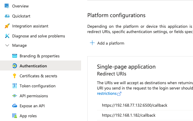

This is showing the Application configuration for my dev lab using internal IPs for the callbacks. The NPS UI is at https://192.168.77.132:6500 and the Portal UI is https://192.168.1.182
I have two authentication connections using this App registration with OIDC.

Could you please clarify further? In the Entra Enterprise application, I am using https://portal.domain.com/samlSigninCallback as the Reply URL. It seems to have a different structure from yours. From my attempts, using https://portal.domain.com/Callback did not work.
/samlSigninCallback is for SAML authentication flow.
/callback is for OIDC authentication flow.

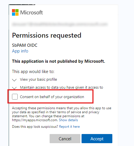

Silly question but did you click on the ‘Consent on behalf of your organization’ box?
You saved my day :slight_smile:
I hadn’t seen this documentation before, but it helped solve the problem.
