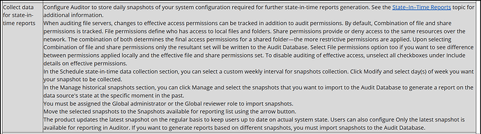

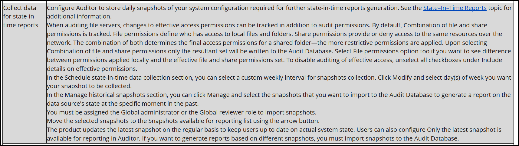

When are S-i-T Snapshots taken?
I know that you can select the days of the week that you want snapshots taken, but when during that day are the sources crawled to gather the snapshot data?
Good morning Marc,
When a Monitoring Plan is created, it uses the time under the Notifications section of the Monitoring Plan to create the very first one. After that, it’s every 24 hours. If you did not change that time when creating the Monitoring Plans, they are running at 3AM or 4AM (depending on daylight savings time).
Note: Changing the time in the notification settings does not change the time of the State-in-Time creation.
