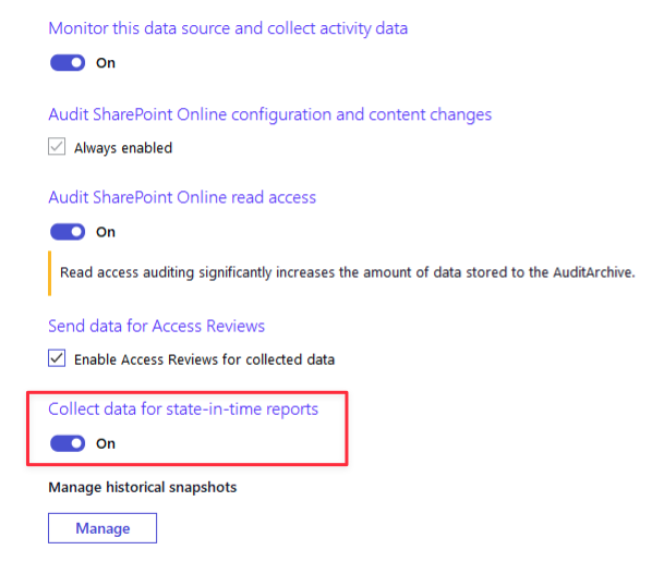

This is most likely an issue with a setting inside of your SharePoint Online Monitoring Plan. If you open your Monitoring Plan, select “Edit Data Source”, you need to enable the option “Collect data for state-in-time reports”. Once you do that, if you wait overnight, it will run and then you should be able to run those reports.
Hi Michael, Good Day!
Thank you for sparing your valuable time for the reply. Please note that, “Collect data for state-in-time” report option is already been selected since I created the Mon. Plan. still, no luck…

When did you create the plan? The State-in-Time typically generates overnight, so if it was created the same day or late the previous day, it may not have had enough time to complete.
In the meantime, could you open the plan, select Edit Data Source, and click Manage under the State-in-Time option? Let me know whether you see anything listed in the left or right columns on that screen.
If something is listed there but the reports still aren’t working, it’s possible the State-in-Time ran into an issue uploading to the database. Do you know which edition of SQL you’re running? Standard and Enterprise editions should be fine, but if you’re on Express, the SharePoint State-in-Time file may be pushing the database size over the Express size limit.

Thank you for the response. I have checked the above options, However, under Edit Data Source, > Manage > Nothing showing here. It’s empty. kindly assist further now. With Thanks!
