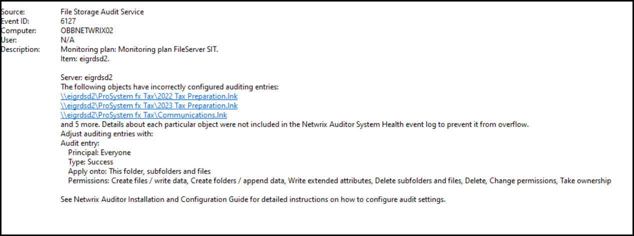

For the plan that is just collecting state-in-time data, I am still getting errors around incorrect audit settings. Is that normal? I didn’t think I needed to add the same exclusions to these Computer items since no audit data was being collected but it looks like I might have to.

It depends on the specific error you’re seeing.
If the error mentions excessive audit settings, that’s expected behavior. Since all of the checkboxes at the top of the plan are unchecked, Netwrix assumes no auditing is required. But because auditing is still enabled due to your other plan, it flags the extra settings as unnecessary.
That kind of warning can safely be omitted. To do that, you’ll need to edit a file located in the Netwrix installation directory. The exact path may vary depending on where the product was installed, but the default location is:
C:\Program Files (x86)\Netwrix Auditor\File Server Auditing\omiterrors.txt
However, if the error is about missing permissions, that’s different. Collecting State-in-Time data alone shouldn’t require any audit policies to be enabled. If you’re seeing permission-related errors, feel free to send those over and I’ll help you review them.

See the attached images.

Marc,
I did some testing and I ended up with the same errors you did. I did some research and discovered that Auditor by default requires the audit settings for Successful Changes. In regards to the shares you are omitting, we still check those, even if we don’t check the data so that is why you are also getting a message about those shares.
Since you do not want to collect Successful Changes with this plan, I would recommend simply omitting any errors regarding auditing settings for this plan.
In the omiterrors.txt file, you could add the following lines.
Monitoring plan FileServer SIT,*,*auditing*
This will prevent those errors from showing up on that Montioring Plan.
One important note though. If those shares are part of your plans that are collecting the Activity, you do need to ensure that you have the object level auditing enabled to collect successful changes. By this SIT only plan giving you that error, it means that those settings are missing from those share. If those shares are omitted on the Activity Plans as well, the it’s fine but if you are not omitting those shares, you do want to ensure that you have the Object Level Auditing enabled.

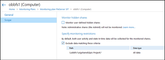

Something in your screenshot caught my eye and I think there is 1 setting you can change to.
In the scope of your File Server plan, you are omitting the share like this
\\obbfs1\eigshared\Epic Project\*
However, it should be this
By adding the * to end, you are saying you want to ignore all of the files in the Epic Project folder but not the Epic Project folder itself. I just tested and confirmed that I got the same error message on the excluded folder when I added the * to it but I didn’t get it when taking that part out.
Ahh, good catch. I will make that change. Thank you!
