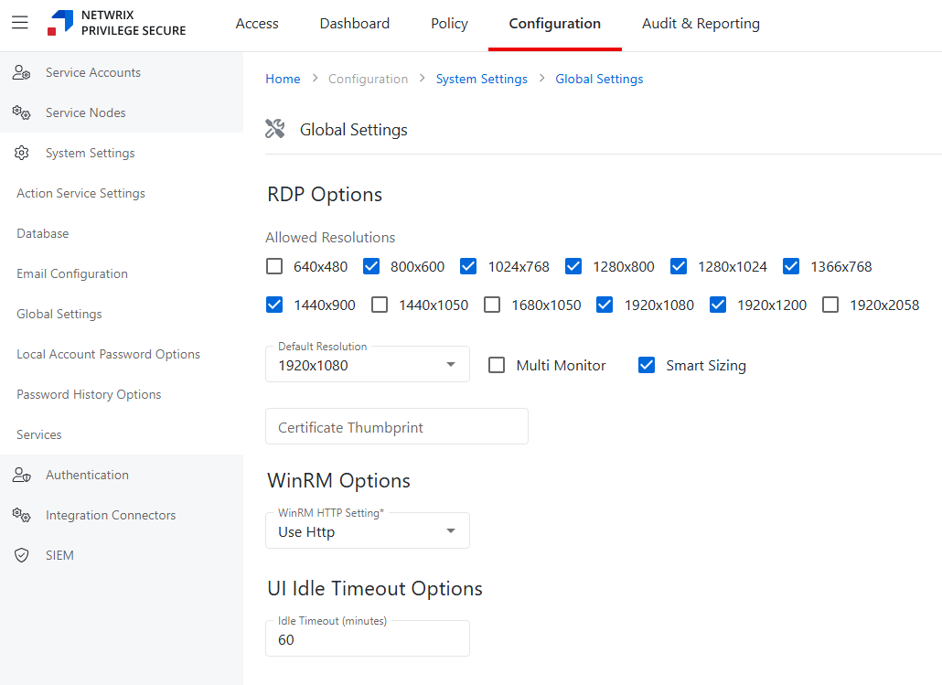

Hello Florian,
thank you for posting to the community. The feature you are looking for is in System Settings => Global Settings => UI Idle Timeout Options
I have set my lab to use 60 minutes.
HTH,
-Kevin
Hi Kevin,
Florians problem is that it is only limited to 60 minutes max. He would like to increase that time out to lets say 4 or 8 hours. The screen timeout in Windows would prevent the unauthorized yes. So long question, is it possible that the end user is able to fill out ANY value instead of only being limited to 60 minutes.
Hi Nils - at this time 60-minutes is the maximum allowed value.
In 26.03, the max idle time was raised to 1000 minutes
