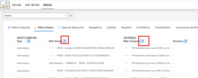

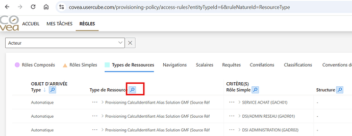

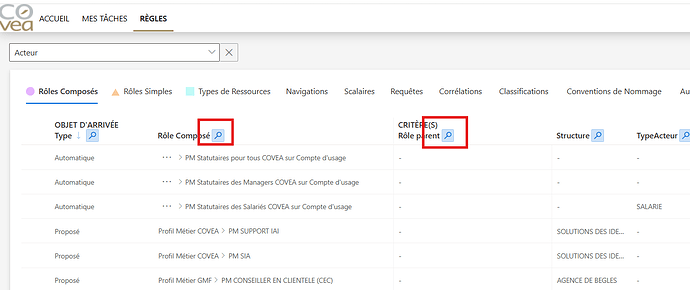

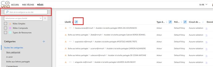

In the “Role” and “Rules” screens of the Netwrix Identity Manager product, searching and filtering columns by role can only be done using the role label. It would be useful to also enable searching by ID.

Hello,
We’ve developed scripts to load our role catalog via the API from CSV files:
  • simple roles
  • composite roles
  • simple role rules (singlrolerule)
  • navigation rules
That’s why we use a lot the role and category identifiers. The identifier is what we use as a search key.
Having a column called „identifier“ in the different NIM product screens, where we can search for items in the role catalog, would be very useful. For example, when we search to see whether a rule involving a role already exists.
Would it be possible to show or hide this column as needed? Or link it to a profile—for example, the administrator profile would see the „identifier“ column, but not the other profiles.
