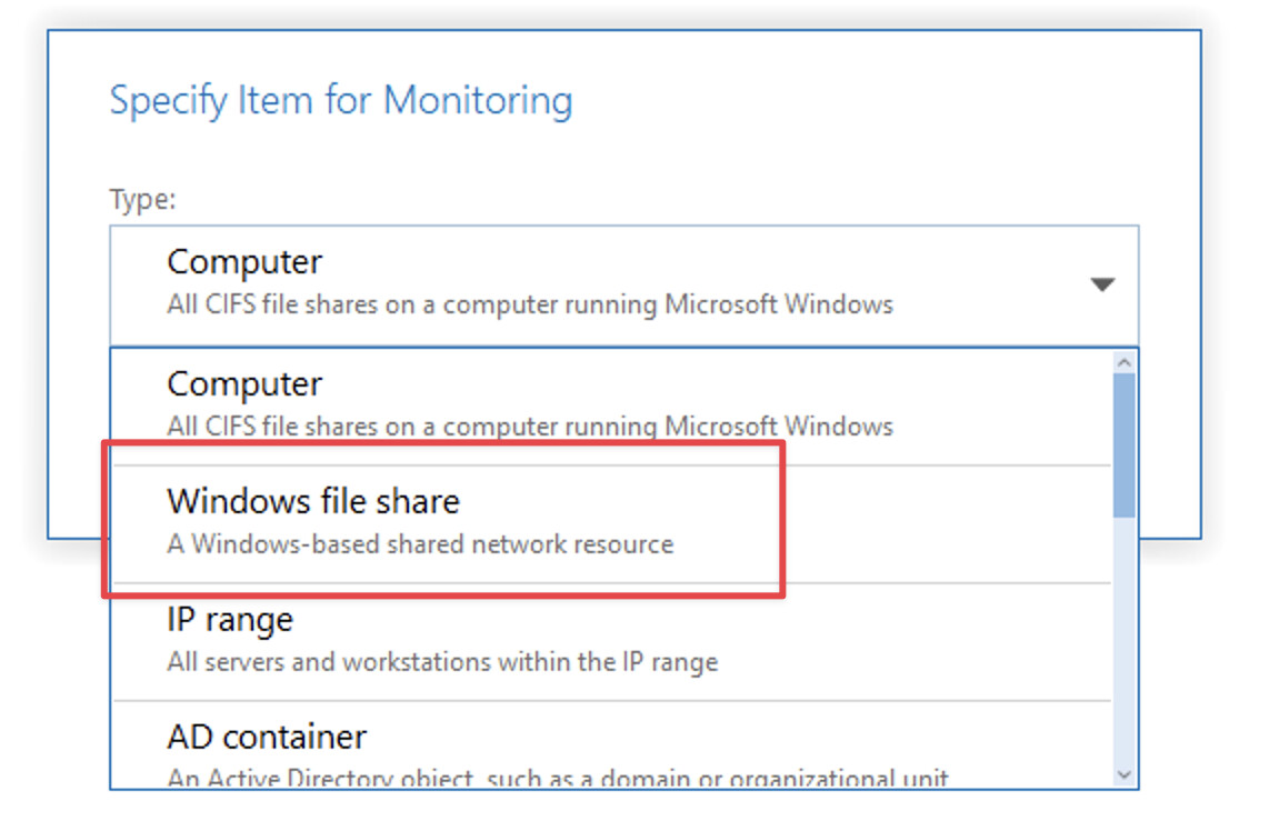

Looking at the ‘special’ monitoring plan and how to set that up, I just see exclusions but nowhere to ‘include’ the shares I want. If I have 200 generic shares but only 5 special shares I want increased auditing, how would I do that? Do I have to manually exclude the 200 so it includes the 5?

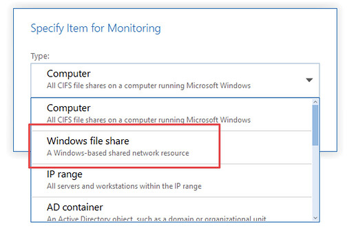

You’re definitely on the right path. For the special Monitoring Plan, when adding an item, be sure not to choose “Computer.” Instead, select the “Windows File Share” option and specify the share directly.
When adding the share, I recommend using the same naming format as your main file server plan. If you’re using the full FQDN in your primary plan, do the same here to maintain consistency across reports and search results.
For example:
If your main plan uses FILE01.DOMAIN.LOCAL, then enter the share as \\FILE01.DOMAIN.LOCAL\ShareName in the special plan.
The section you found in the screenshot is exactly where you’ll exclude any shares from the main file server plan that you intend to monitor separately in this new plan.
