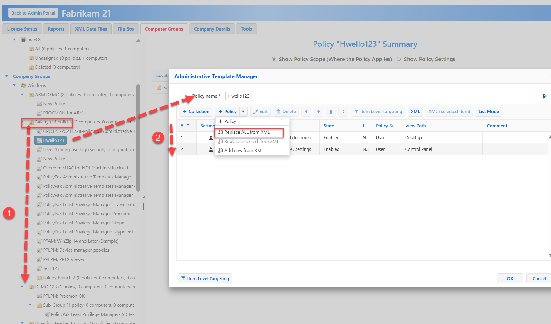

Note there are two locations and two types of link orders.. I’ll mark them as 1 and 2 here…
The left one (1) is multiple policies affecting a group of machines.
The right one (2) is policies of a specific type, wrapped up as a bundle.. in this case.. admin Templates manager policies.
I think I get what you want: You want to “Photocopy the Bakery group with its 16 policies”… then Replace Hwello123 policy with another one .. keeping the link order where Hwello123 is in the left order… and “see how it reacts.”
Stop: Do I have it right?
Then, also as a stopgap measure, note that INSIDE a policy you can “Replace ALL from XML” and keep Hwello123 in its existing link order but replace all the guts of Hwello123 with whatever you want.

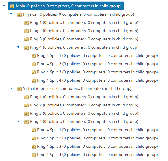

Unfortunately, no. We have a main Company Group with physical and virtual parents that contain production rings.
We have a few other Company Groups for specific tasks, audits, workflows, etc., but that’s our main breakdown. These Company Groups can have anywhere from 1 or 2 policies up to 50 policies.
