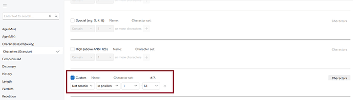

Based on what you are looking to accomplish, this can be achieved through the utilization of the Characters (Granular) rule in a PPE Policy. In the Characters (Granular) rule, you are able to designate the “Not contain” option and the characters button to assign the specific characters you wish to have included in the rule. For this example I used the Custom portion of the Characters (Granular) Rule:

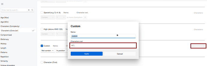

What I have here is assigned #,? and SPACE as the character set using the characters button:
Then I set the first box to “Not Contain”, second box to “in position” and positions “1” and “64”. Currently 64 is the highest position we can specify. This will reject a password containing #, ? or SPACE in any position between 1 and 64 in a password.
The reason I used “in position” instead of “embedded” option is because “embedded” will only reject these characters in a password if it is inside the password, so the first and last character(s) in a password will not count, so for example if using “embedded” the password “#PasswordExample” or “PasswordExample#” will still be accepted and “Password#Example” will not be accepted.
When using “in position”“1”-“64”, all three examples will be rejected. (“#PasswordExample” or “PasswordExample#” or “Password#Example”).

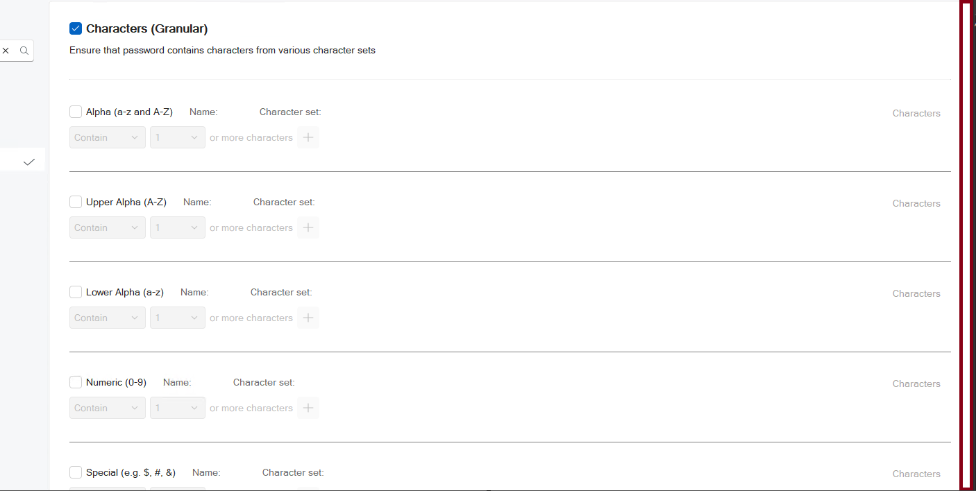

Unfortunately, when i go into PPE and the characters (Granular) section, i do not have the option for “custom”. I can repurpose the “special” option and can set it up almost exactly as in your screencap. Out of curiosity, what version is your screencap? I look to be on 11.0.2.2.
thank you!

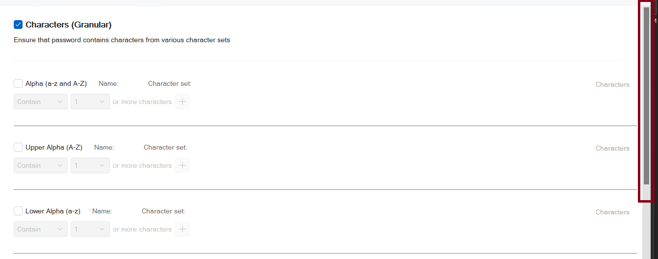

11.0.5.5, the Custom option is further down the page. Scrolling does not work, you need to hover on the right side of the screen to get the bar and drag it down to go down the page:
Now I feel very silly.
Was able to find the custom options by draggging the scroll bar.

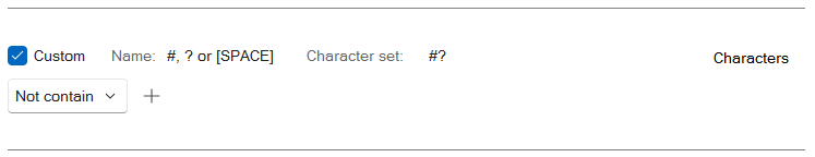

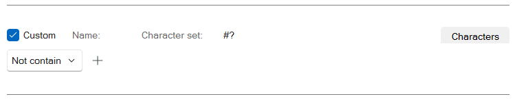

Hi @adrianjatmoi. Just a little bit of additional information for you. The commas are not needed in the custom character set definition. Adding them will cause PPE to also reject passwords that contain commas. Just add the characters that you want blocked. Also, while it is OK to specify the start and end character range, it is not required if you want to block these characters anywhere in the password. This is equivalent and a little easier to understand:
If you are using the PPE client, then you may also want to rename the character set to “#, ? or [SPACE]” as shown below.
This will give you a more helpful message in the PPE client:
