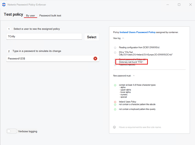

In the screenshot below, using the default dictionary that comes with the platform, a testing a user against the policy you can see the word was identified and rejected.

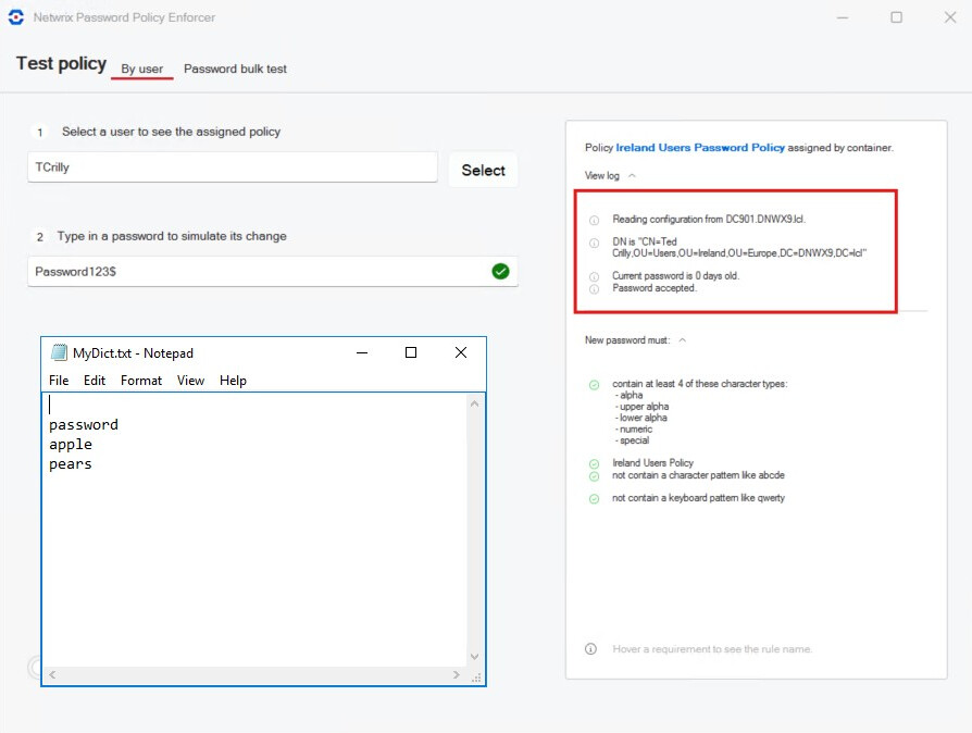

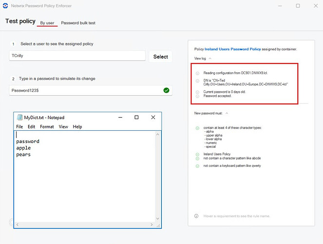

However, when using a custom dictionary the disallowed entry is not detected and the user is able to set a password.
I can confirm the custom dictionary has blank entries at the start and end of the file.

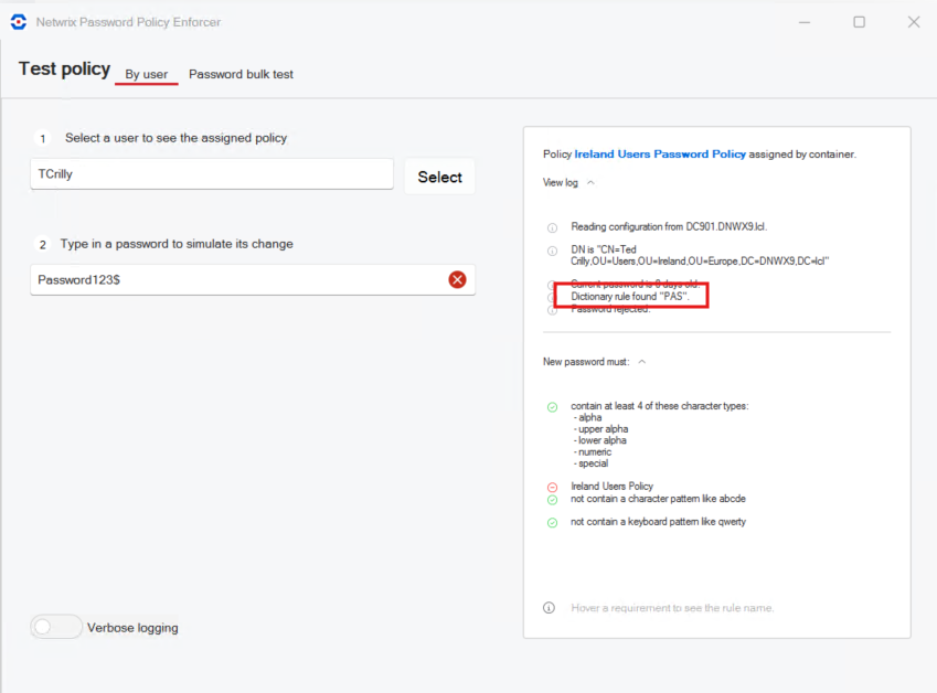

The terms also must be all caps. Please use the sort function in the dictionary rule and try again.
Hi Robert,
Thanks for the fast response, adding all the entries in uppercase and sorting via the rule resolved the issue in my tests.
I will pass this info back to the client so they can test.
