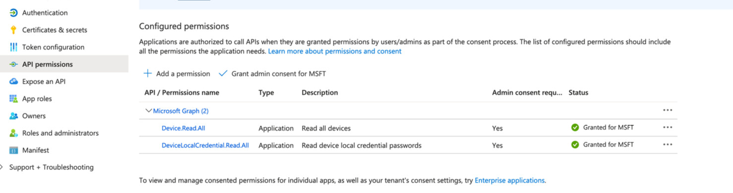

# Extract the Azure vault information
$azureTenantId = $Options.Connector.Options.APIUrl
$azureAppId = $Options.Connector.Options.AppId
$CertificateThumbprint = $Options.Connector.Options.ClientCertificate
$AZApp = $Options.Connector.Name

Yes, like anything utilizing app-only access and the MS Graph powershell module, a valid certificate is needed for client – server authentication between NPS-AM Action Service servers and EntraID. The Base64 Public Key file is used by the Azure registered app to authenticate. Also, the Azure App Registration requires permission to use Microsoft.Graph and read device permissions and read device local credential passwords.
Additionally, each NPS-AM Action Service server (meaning each server where NPS-AM is installed and any individual Action Service servers) need:
  • the cert used for auth to be valid (complete certificate chain to the Root Store) and installed
  • Powershell 7 and the Microsoft.Graph Module installed

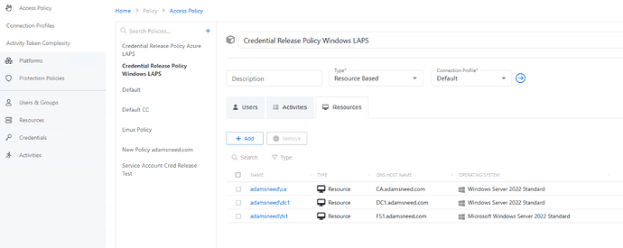

Then create an Activity that uses the integration connector we just created and the settings here (If you have changed your local administrator account names replace the value to match in the Login Account Template field):
Finally, tie everything together via an Access Policy that is using a connection profile that allows for password viewing (alternatively you can require this only be used with the RDP files through the proxy service and not allow for the password to be viewed)

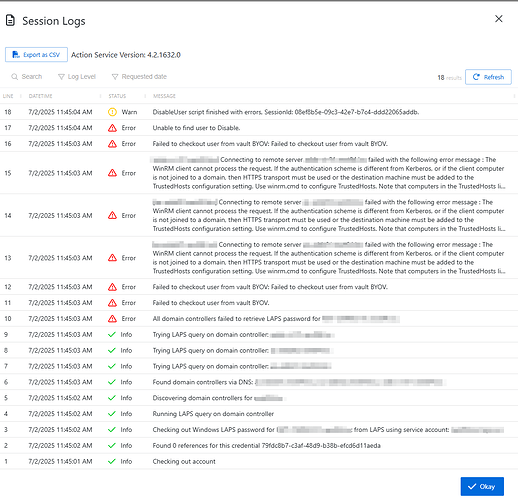

However, when I tested the integration, it resulted in an error. I’ll include a screenshot and the relevant log entry to help troubleshoot.
statusString,status,logMessage,lineNumber,timestamp,version,id
"Warn",2,"DisableUser script finished with errors, [REDACTED]: 8ae5f530-b9aa-436f-b8f3-ee167b6c7ffb.",18,"2025-07-02T09:48:00.690472Z","4.2.1632.0","18"
"Error",3,"Unable to find user to Disable.",17,"2025-07-02T09:48:00.662966Z","4.2.1632.0","17"
"Error",3,"Failed to checkout user from [REDACTED]: Failed to checkout user from [REDACTED].",16,"2025-07-02T09:47:59.779386Z",,"16"
"Error",3,"[[REDACTED].[REDACTED]] Connecting to remote server [REDACTED].[REDACTED] failed with the following error message : The WinRM client cannot process the request...",15,"2025-07-02T09:47:59.759057Z",,"15"
"Info",1,"Trying LAPS query on domain controller: [REDACTED].[REDACTED]",9,"2025-07-02T09:47:59.620116Z","4.2.1632.0","9"
"Info",1,"Checking out Windows LAPS password for [REDACTED].[REDACTED] from LAPS using service account: [REDACTED]\\[REDACTED]",3,"2025-07-02T09:47:59.311206Z","4.2.1632.0","3"
Let me know if you’d like me to share any specific configuration details or if you have suggestions on what to check next.
Thanks so much in advance!!
It looks to be a permissions issue. Do your windows resources use the same service account as Active Directory? You need to make sure that account has the following permissions:

We have already verified and applied all the required permissions:
  • The service account is a Domain Admin, and therefore already has:
    • “Log on as a service”
    • “Access this computer from the network”
    • Remote PowerShell Access via membership in the Administrators group
  • Regarding Windows LAPS, the account has:
    • Read permissions on the ms-LAPS-Password attribute
    • All extended rights on the relevant computer objects
Despite all of this being in place, the error remains unchanged.
Would it be possible to contact support regarding this issue (even if this feature is not yet fully implemented)?
Thank you so much for your responses and help!
