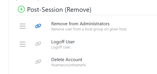

Hi Kevin,
I had some time to test your workaround, and while it works technically, the Windows session remains open if the user doesn’t sign out—even after the timeout set in the connection profile. From a security standpoint, this is less than ideal, even though the I/O recording continues to run.
Regards
Benjamin
to enforce a signout at the end of the session, you will need to add the “Logoff User” step to the activity.
When the session ends, after removing privilege from the user it will search for any open Sessions from that user on the target host and disconnect the user.
