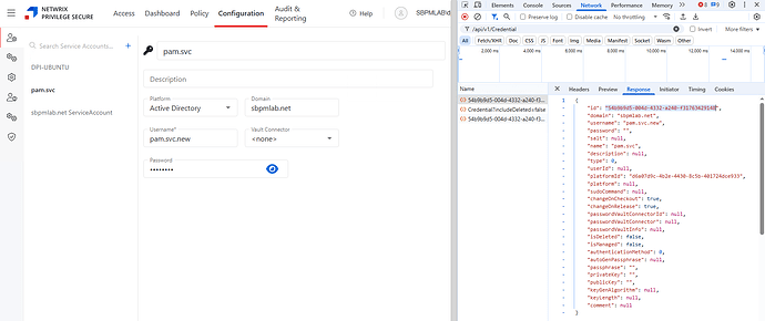

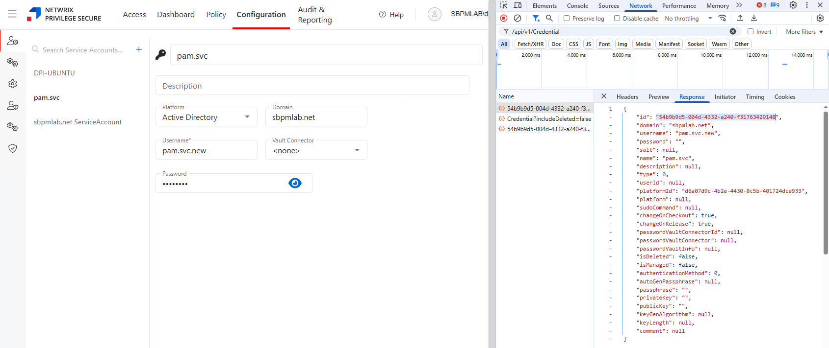

First, we need to locate the ID (GUID) of the service account we want to assign to all of our resources. We can do this in Privilege Secure on the Service Accounts page with our browser’s Developer Console open to the Network tab.
:information_source: Each browser is different, but in Google Chrome the Developer Console can be opened by pressing Ctrl + Shift + I or by opening the menu and navigating to More Tools > Developer Tools.
Set the Network tab’s filter to /api/v1/Credential then click the :prohibited: button in the upper-left to clear old data. Now, click on the service account you want to assign to your managed resources. In the Dev Console, click on the API call and check the Response tab - the first property will be that service account’s ID, which we’ll use when making calls to Privilege Secure’s API.

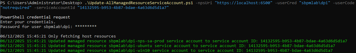

The script can be excuted in PowerShell, such as the following example. Please note the userCred needs to be a Privilege Secure admin user. userCode is the user’s MFA code, and serviceAccountId is the service account ID we found earlier.
:information_source: If the user does not use MFA, the userCode parameter is still required. However, since the user does not have an MFA code, you can simply use any placeholder text (such as “notrequired”).
.\Update-AllManagedResourceServiceAccounts.ps1 -npsUri "https://nps-server.domain.net:6500" -userCred "domain\my_user" -userCode "notrequired" -serviceAccountId "14132595-b953-4b87-bdae-4a63d6d5d1a7"
There’s also an optional parameter that can be used when executing the script: UpdateAllExistingServiceAccounts.
By default, the script fetches managed resources of type host but will skip other resource types such as domains. If you’d like to change the service account on all resource types that use a service account, you can add the aforementioned parameter when executing the script.
When you execute the script, you’ll be prompted for your Privilege Secure user’s password. Once that is input, the script will fetch managed resources and assign the specified service account.
