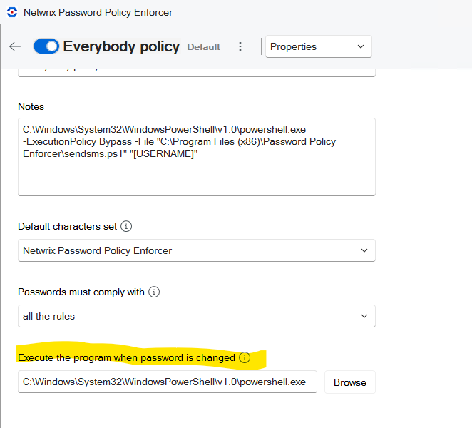

A little known but powerful feature of Netwrix Password Policy Enforcer is the ‘Execute A Program When Password is Change’ setting in the properties pane of each policy:
This feature will allow you to call a program or script when a user changes his or her password. This can be used to sync credentials, launch another process or in this case, send an SMS message to the user notifying them that their password has changed. This can help protect against unexpected password changes done by bad actors via phishing, social engineering, or lateral movement.

  1. Open the policy in question in PPE and navigate to the policy properties on the top menu.
  2. Set the following line with the correct path into the “Execute The Program When the Password is Changed” field:
C:\Windows\System32\WindowsPowerShell\v1.0\powershell.exe -ExecutionPolicy Bypass -File "C:\PPE\PassChangeNotification.ps1" "[USERNAME]"
