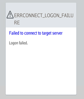

Hello everyone,
We are currently performing the initial installation of the PAM machines. However, when we attempt to connect to any machine after completing the provisioning correctly, we open the RDP file that is created, but the attached error appears.
On the first machine we do not have any problems, but only in the second one.
The machines are in HA.

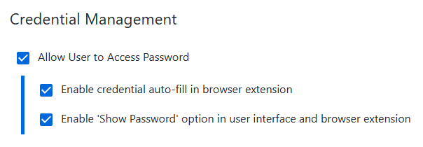

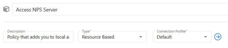

In your Access Policy configuration, there is a setting Connection Profile
My “Access NPS Server” policy is show below. Click the Blue Arrow, to go to the Connection Profile for your policy.
Scroll down to Credential Management
Select the Enable 'Show Password' option
Scroll down and click Save
HTH,
-Kevin
I enabled what you instructed, and I managed to connect via PAM (no RDP) without copying the password, and it worked on both machines! Then, I tried disabling the password visibility again, restarted the servers, and it still works.

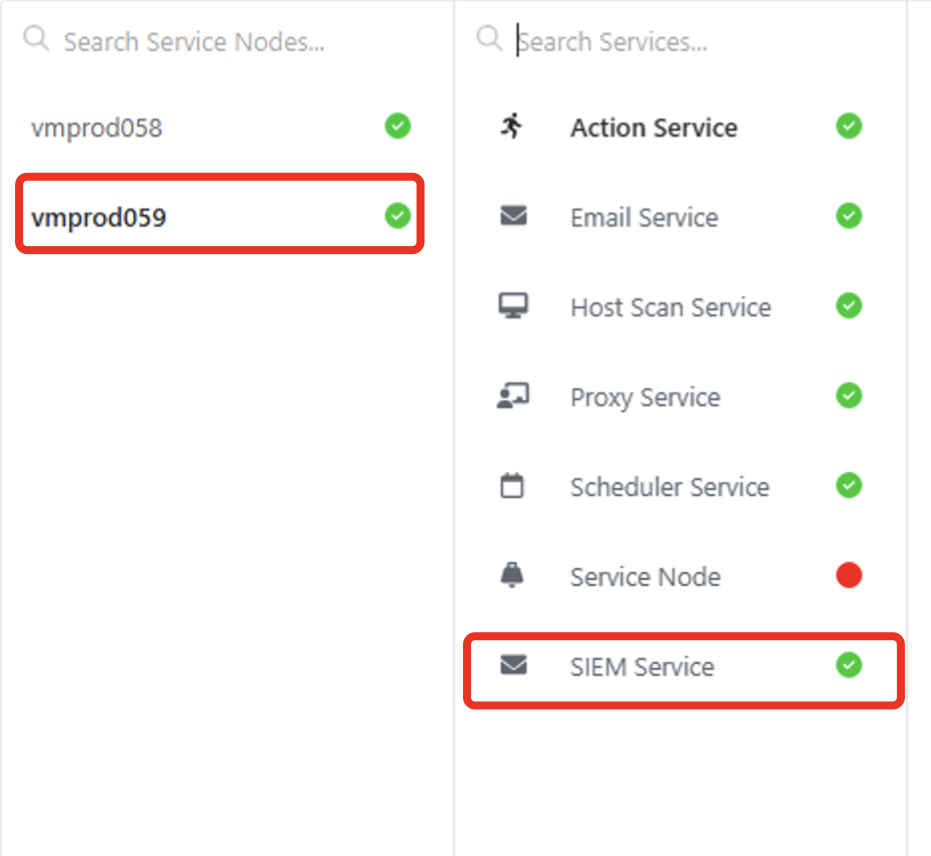

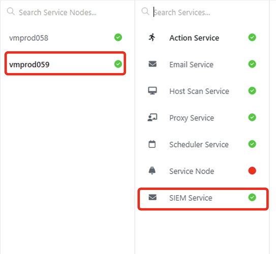

Additionally, I noticed that previously, when the issue was still present, the “SIEM Service” entry was red on the problematic machine; now it appears as follows:
Thank you,
Giacomo.
