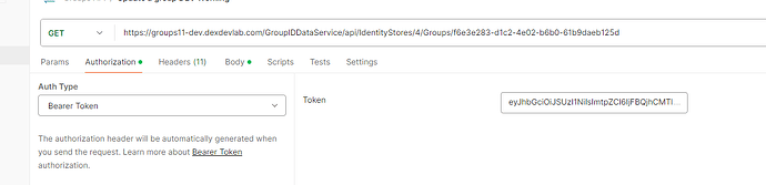

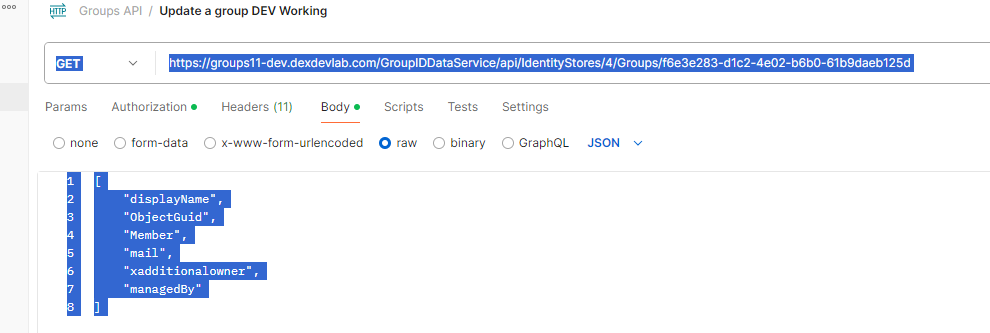

Make sure your call looks like this in postman once you have the token
https://GROUPSURL/GroupIDDataService/api/IdentityStores/4/Groups/IDENTITYSTOREID
