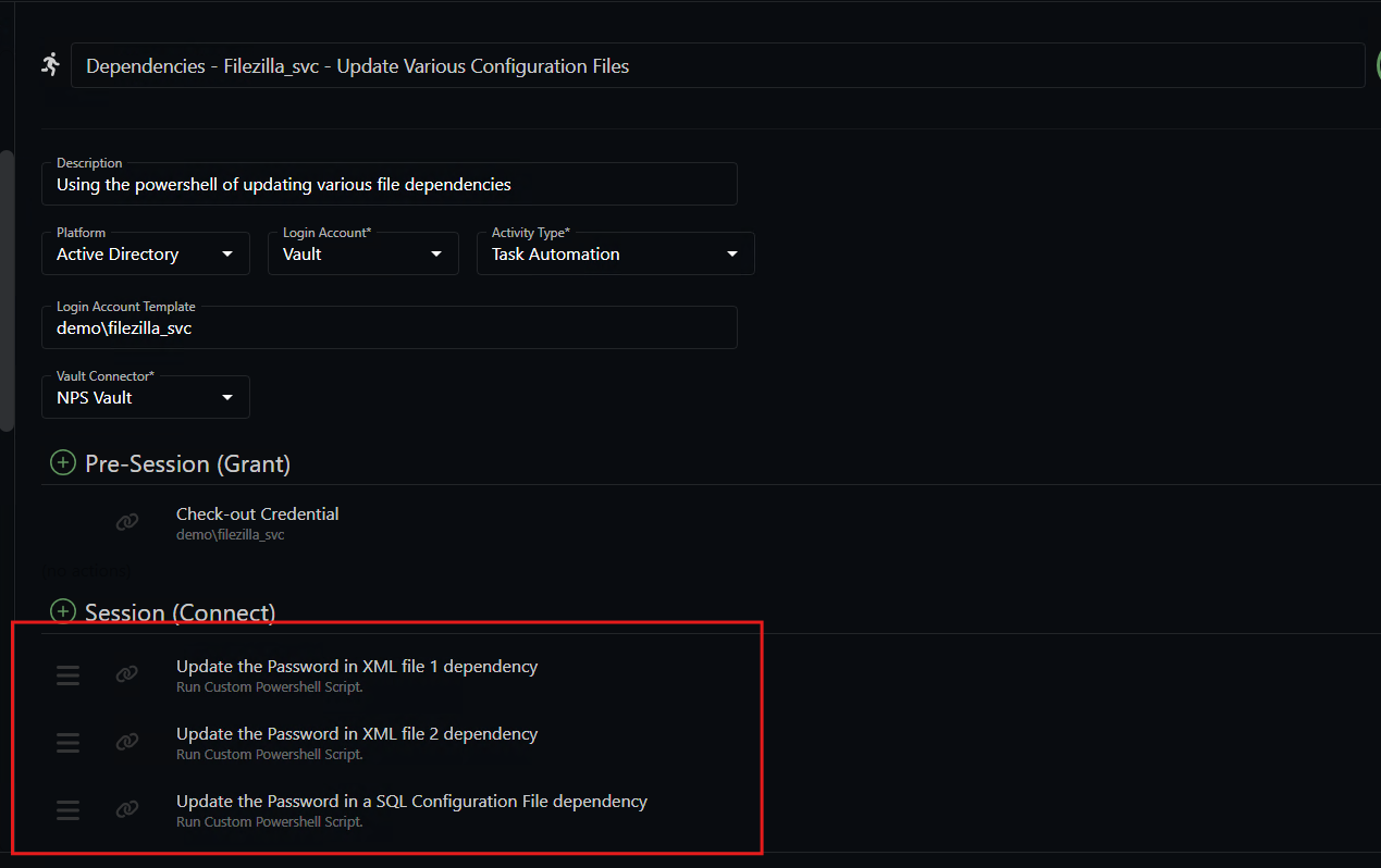

Here is a screenshot of an example activity:
Activity Type = task automation
Login Account Template = the absolute name of the service account you’re looking to retrieve the password for
Vault Connector = The BYOV connection explained earlier
Session (Connect) = is where I chose to run the custom powershell script.
When the Activity runs, NPS will update the file(s) specified in the script(s) with the current service account password. This would be something you could run AFTER you’ve gone through the Service Account rotation process for discovered Windows Services and Scheduled tasks: Account Dependencies Window. The scripting process allows you to further extend NPS’ functionality.
