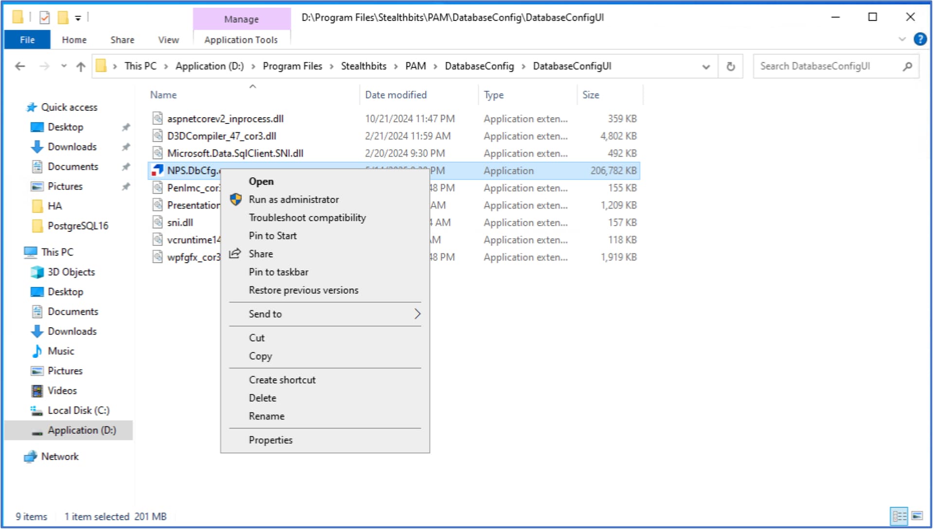

  • Log into your NPS-AM server and navigate to the following path on your application drive (replace x with the appropriate drive letter)
x:\Program Files\Stealthbits\PAM\DatabaseConfig\DatabaseConfigUI
  • Right click on NPS.DbCfg.exe and run as administrator.
This will launch the Netwrix Privilege Secure Database Configuration Tool:

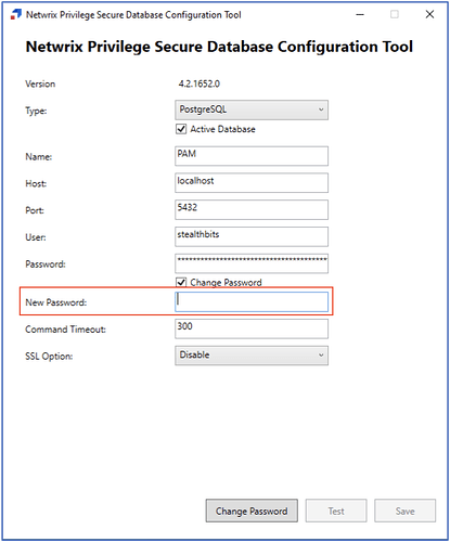

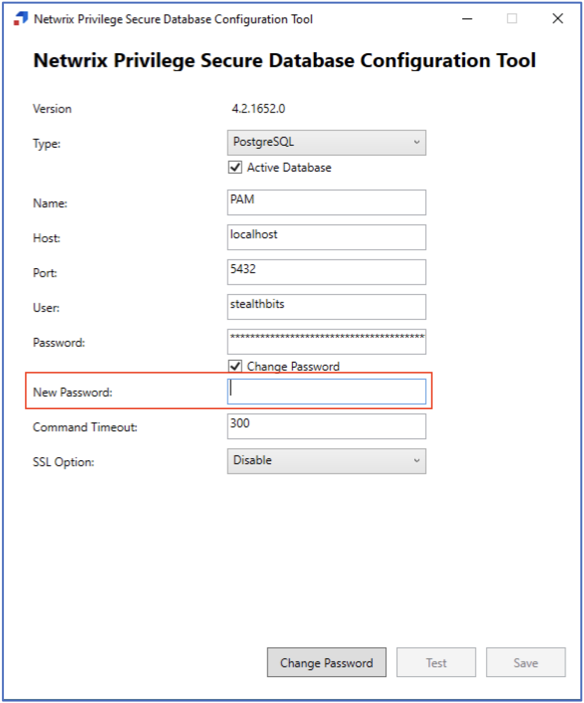

  • Select the radio button to change password and fill in your new password in the empty box.
Then select “Change Password” then “Test” and finally “Save”. If you have a single PostgreSQL server, the password update is complete. (see below to test connection and then update your secondary
server).

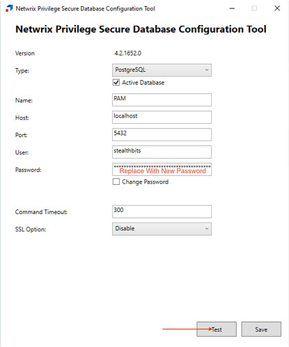

Verify New Password
To verify the change, you can close and reopen the Database Configuration Tool and replace the obfuscated password with your new password and select “Test” to verify your ability to connect to the database.
You should then see a message that your connection was successful.
