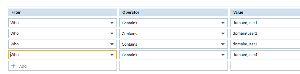

Hello,
To achieve your search criteria you need to switch “Search” to the advanced mode and use operator “Not equal to” for usernames.
It is not supported multiple values in Value.
Example:
More information can be found here:
Thank you!

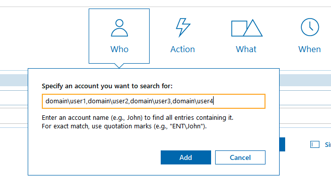

Aleksandar,
Another easy way is to use the buttons at the top of the search. If you click on the WHO button, you can enter all of the users at once by putting a comma in between them.
Once you click on “Add”, it will add them as individual rows.
If you have any other questions, feel free to reach out.
Michael Purdin
Netwrix Technical Support Manager
Thank you. This is it.
