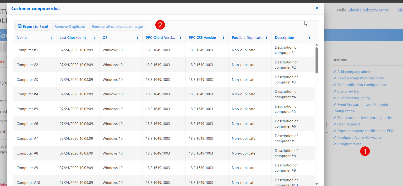

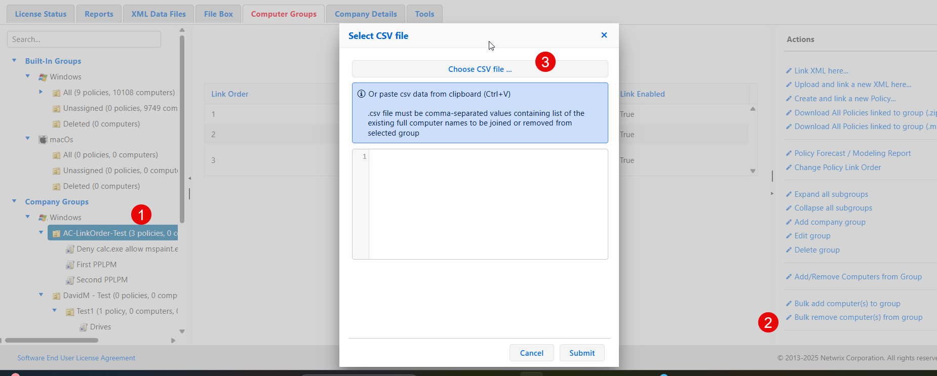

But, we already have a BULK delete in PPC. Just do this…
And get the computer names like this and trim it before uploading..
I’m 95% sure this gets you what you want today using COMPUTER name but not Serial number since we dont capture that anyway. Let me know. Thanks !
For that, it looks to be limited by “Groups”. We have a lot of groups :slight_smile: So I guess we would have to take that list, move them to a ‘new group’, then do the deletion against that group.

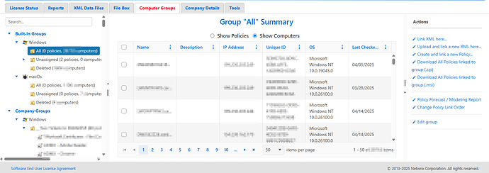

Unless we’re missing something (very possible :stuck_out_tongue: ), we’re only seeing the bulk remove option in Company Groups, not in the All built-in group.

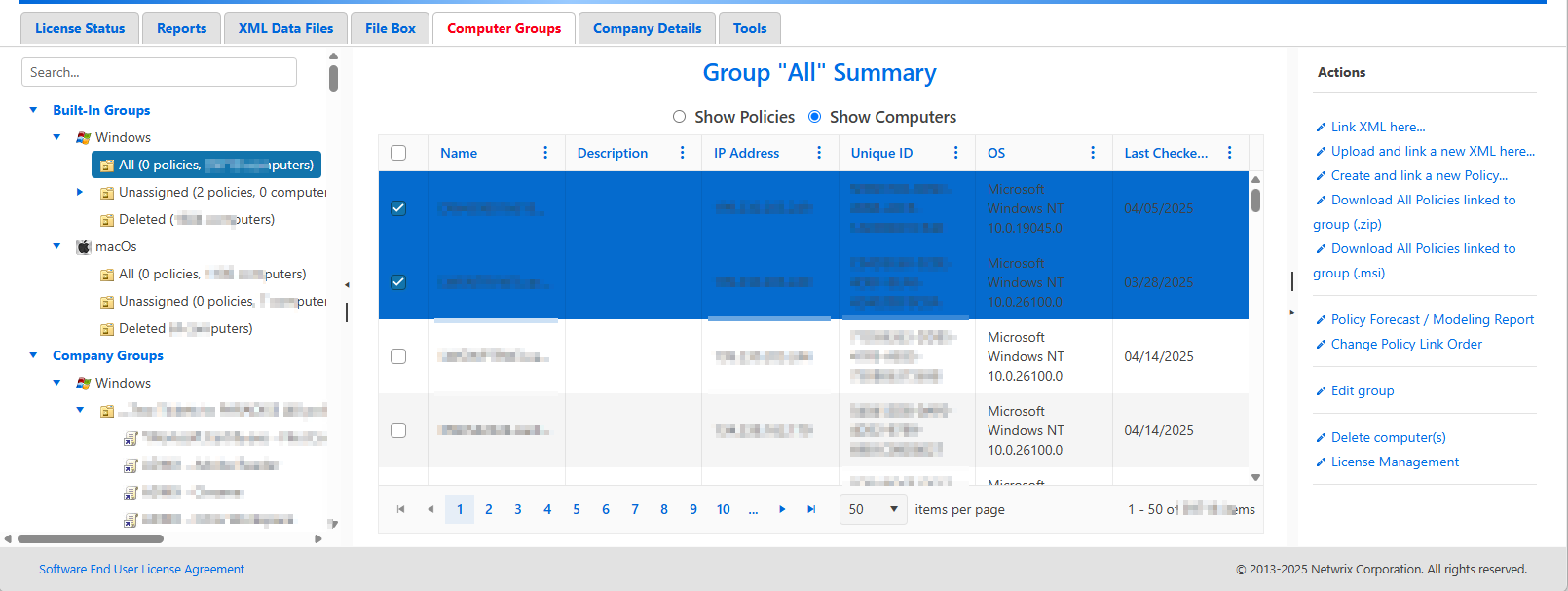

Granted, yes, we CAN bulk delete from All as long as we manually select multiple computers…
…but searching for, selecting, and deleting a few hundred computers like this is not really an option.
Which leads us back to Matt’s outline of bulk adding to a different Company Group then bulk deleting from there since we can select all from the Show Computers section.
