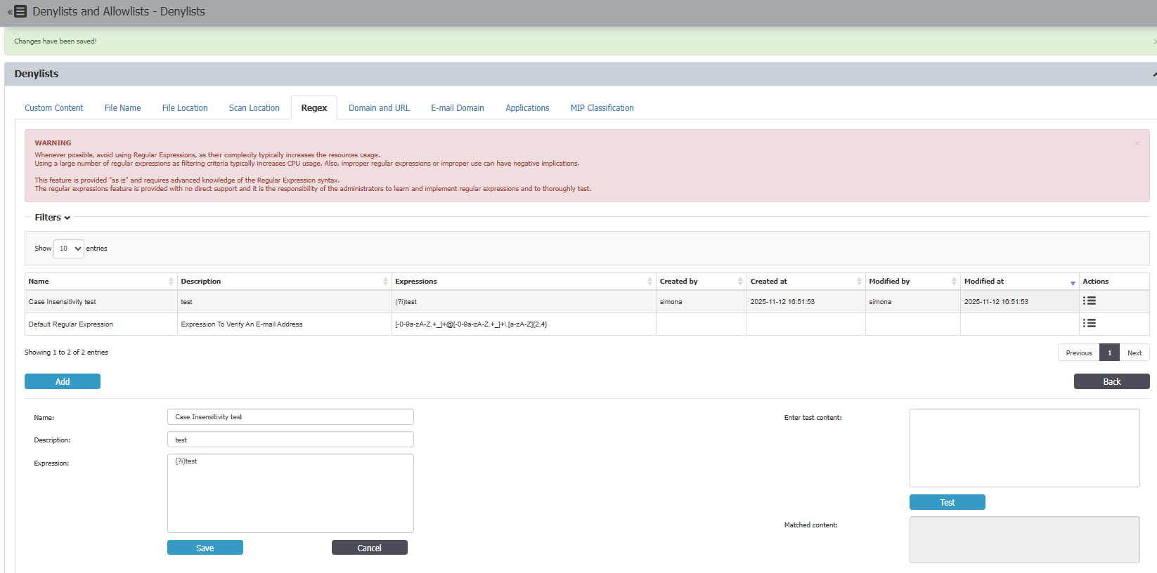

Hello Bree,
We have some important updates regarding this topic. After conducting additional internal testing on this scenario, we’d like to share the following results:
EPP supports both standard Regex syntax and Perl-Compatible Regular Expression (PCRE) extensions and modifiers. For example, you can use the (?i) modifier at the beginning of a regex pattern to make it case-insensitive during matching.
In the following example, the pattern (?i)test will match “test,” “Test,” “TEST,” and other variations, regardless of letter case, as follows:
1. In this section, the Regex pattern is defined, added to the dictionary, and saved. Ensure that it is also included in the CAP Policy for proper application.
  1. The Content Aware Report confirms that the test has completed successfully and that case-insensitive matching is functioning as expected.
